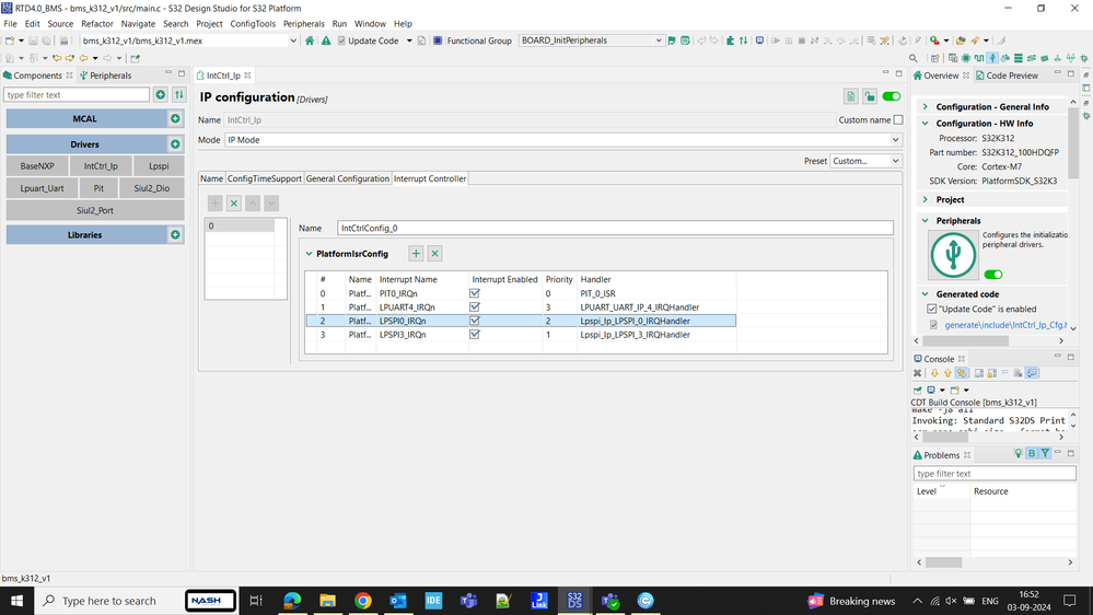

Hareesh
Hi @PetrS ,
We tried to capture SPI signals when the BCC_MCU_TransferTpl() function is calling, but we didn't get any response on the SPI lines.
The below section shows the interrupt configurations of SPI module in the code.
	/* Initialize IRQs */
	IntCtrl_Ip_Init(&IntCtrlConfig_0);
	IntCtrl_Ip_InstallHandler(LPSPI0_IRQn , Lpspi_Ip_LPSPI_0_IRQHandler, NULL_PTR);
	IntCtrl_Ip_EnableIrq(LPSPI0_IRQn);
	IntCtrl_Ip_InstallHandler(LPSPI3_IRQn , Lpspi_Ip_LPSPI_3_IRQHandler, NULL_PTR);
	IntCtrl_Ip_EnableIrq(LPSPI3_IRQn);
   /* Initialize LPSPI instances. */
     error_spi = Lpspi_Ip_Init(&Lpspi_Ip_PhyUnitConfig_SPI_MASTER_Instance_0);    //TPL_tx--SPI0
     if (error_spi != LPSPI_IP_STATUS_SUCCESS)
         return;
     error_spi = Lpspi_Ip_Init(&Lpspi_Ip_PhyUnitConfig_SPI_SLAVE_Instance_3);    //TPL_rx--SPI3
         return;
     Lpspi_Ip_UpdateTransferMode(MASTER_EXTERNAL_DEVICE.Instance, LPSPI_IP_INTERRUPT);
     Lpspi_Ip_UpdateTransferMode(SLAVE_EXTERNAL_DEVICE.Instance, LPSPI_IP_INTERRUPT);
The below image shows the SPI interrupt configuration.
