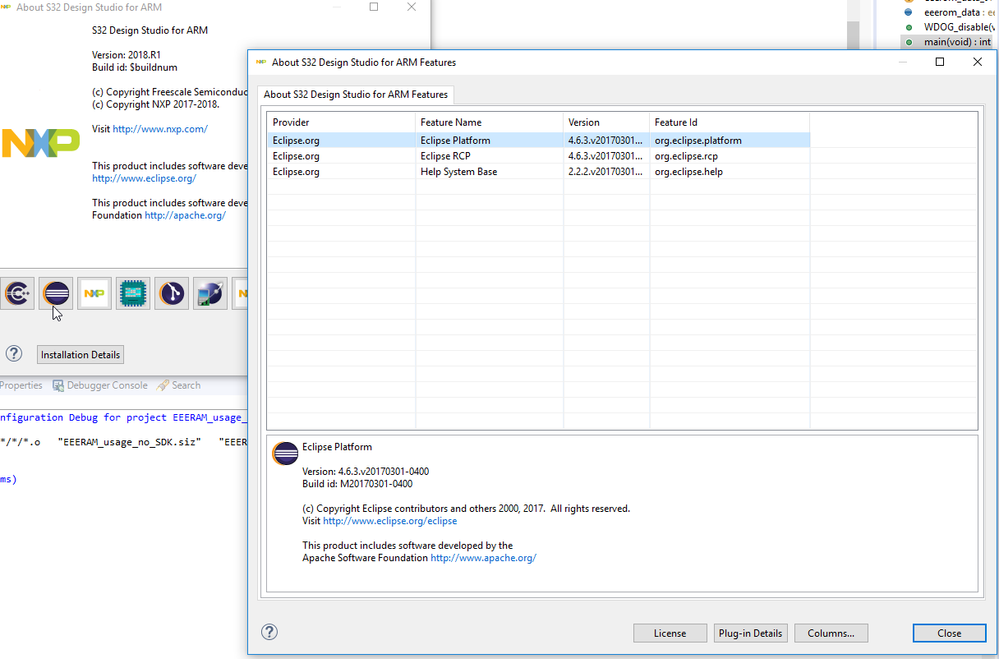

I'd like to be able to update/ lock/ commit to Subversion (SVN) using the S32DS IDE - ideally with a plug-in like Subversive for Eclipse.
However, because Subversive expects you have the Eclipse Marketplace Client (MPC), I'm having difficulty installing it.
What do you guys use for version control on S32 projects?

New S32DS are based on Eclipse Neon. You can get Eclipse version from Help -> About S32DS For ARM
You can install any official eclipse plugin - including SVN.
Hope it helps.
Jiri
