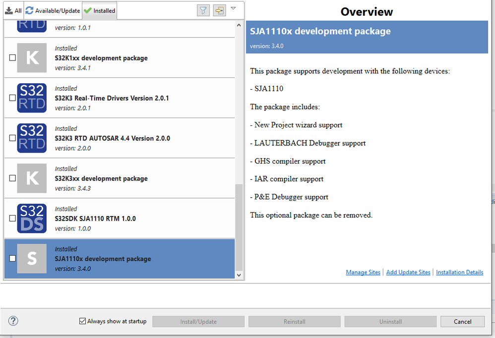

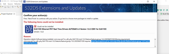

I updated S32DS-3.5 and then adding SJA1110 ETH PHY to S32DS. It is not loading and error is "org.eclipse.equinox.p2.iu; com.nxp.s32ds.sja.dev.feature.feature.group 1.0.0' but it could not be found."

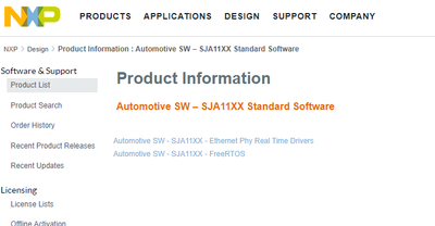

You should be able to use the following link to entitle your account to the SW downloads for SJA1110. There you will find the SJA1110 development package download and you can use it to satisfy the dependency for the ETH PHY package.
Apologies for the delay. We have determined that there is an issue with the publishing of this package. We are working to resolve the issue. We will let you know once it is resolved and provide instructions to access.
