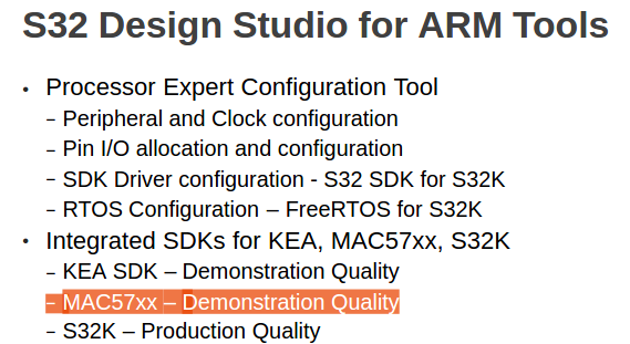

chihoyoun
Dear NXP team.
I think the cheapest&easy develop environment configuration is next:
S32DS + PE Micro(Internal flash & external QSPI algorithms)
P&E's NXP Kinetis MAC57D54H Flash Programming, Debug, and Test
And Can I get the MAC57D54H SDK specified in the next article?
 Enabling Technologies: S32 Design Studio Overview
thanks
