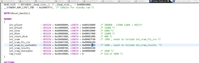

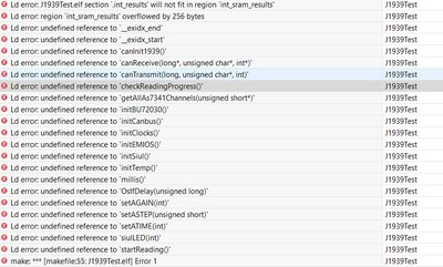

I am trying to work with linking my c++ code with my C files that are running the s32k3 RTD peripherals, but I'm having two issues, one with the sram size, and the other that all my C functions are seen as undefined references. exidx_end and start come from something not in my code so I have no idea how to fix that.
/local/nxa09502/release/opt/freescale/Earmv7nGCC/obj_gcc/arm-none-eabi/thumb/v7e-m+fp/hard/libgcc/../../../../../../src_gcc/libgcc/unwind-arm-common.inc:370: undefined reference to `__exidx_start'

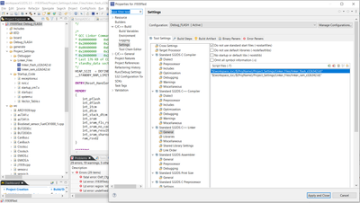

I do have the Linker files added to the Linker > General which removed some errors so I do not know why exidx_end/start are unseen or where they would be
For example, it does not see setAGAIN/ASETP/ATIME despite time being in headers in the same folder, and the includes are included.
It does not seen any of the functions I have in any of my non .hpp and .cpp files
I also see that it says the sram area has overflowed, looking at the linker files I tried shifting memory from no_cacheable to results which did remove the error but I am a little afraid to touch any of it and it did not fix the rest of the undefined reference issues so I would like any advice on how to distribute memory.
Included the whole error log below.

6 返答(返信)
3,235件の閲覧回数
Julián_AragónM
Hi @pb632146,
Firstly, as I'm sure you know since you are working with RTD drivers in C, C++ is unfortunately out of this community's scope of support. That said, I can still give you some pointers to try and fix the issue.
 __exidx_start__exidx_end are symbols used by the compiler to form an exception-handling index. It seems you do not have them initialized inside your linker file. You can refer to this community post where a similar question was asked: What is the function of section named ".ARM.exidx" in ld script - NXP Community.
Julián
3,205件の閲覧回数
pb632146
Contributor V
It appears to be an issue with the linker file in S32K342's SDK as I see exidx_start and end do not appear in it but appear in the linker files for S32K344's SDK. I am currently on RTD 3.0.0 Rather than 5.0.0 as the update did not appear in the extensions and updates window and updating now would break some things. Would it be possible for you to upload the linker files for S32K342 from RTD 5.0.0 so that I can compare them against the ones I have? I have attached the ones I have from 3.0 though I imagine you have them already.
That said I have added the lines from the provided link, and the code does compile, but when uploading to debug something appears to go wrong with the program counter as it points to a completely invalid location instead of the start of main. However I can see by looking at the disassembly that the program has flashed correctly and that the start of main is there, I just need it to point to the correct starting location. I know you said c++ is out of the scope but given that this is related to the compiler/debugger provided with s32ds do you have any idea what the issue could be for the program counter to not be pointing correctly?
3,181件の閲覧回数
Julián_AragónM
Hi @pb632146,
You can find attached the default linker files for S32K344/342. Also, as you said that the program is flashed correctly, if you try to reset the board, does the program run?
Julián
3,203件の閲覧回数
pb632146
Contributor V
the location it is stuck at is a global variable in sram I do not really know what to make of it
3,252件の閲覧回数
pb632146
Contributor V
I was missing
#ifdef __cplusplus
extern "C" {
#endif
#ifdef __cplusplus
#endif
for the headers, which resulted in it not seeing the functions, however "__exidx_end" and "__exidx_start" still are unseen, where are they from?
3,236件の閲覧回数
pb632146
Contributor V
c:/nxp/s32ds.3.5/s32ds/build_tools/gcc_v10.2/gcc-10.2-arm32-eabi/bin/../lib/gcc/arm-none-eabi/10.2.0/../../../../arm-none-eabi/bin/real-ld.exe: warning: c:/nxp/s32ds.3.5/s32ds/build_tools/gcc_v10.2/gcc-10.2-arm32-eabi/bin/../lib/gcc/arm-none-eabi/10.2.0/../../../../arm-none-eabi/lib/thumb/v7e-m+fp/hard\libnosys.a(_exit.o) uses variable-size enums yet the output is to use 32-bit enums; use of enum values across objects may fail
c:/nxp/s32ds.3.5/s32ds/build_tools/gcc_v10.2/gcc-10.2-arm32-eabi/bin/../lib/gcc/arm-none-eabi/10.2.0/../../../../arm-none-eabi/bin/real-ld.exe: J1939Test.elf section `.int_results' will not fit in region `int_sram_results'
c:/nxp/s32ds.3.5/s32ds/build_tools/gcc_v10.2/gcc-10.2-arm32-eabi/bin/../lib/gcc/arm-none-eabi/10.2.0/../../../../arm-none-eabi/bin/real-ld.exe: region `int_sram_results' overflowed by 256 bytes
c:/nxp/s32ds.3.5/s32ds/build_tools/gcc_v10.2/gcc-10.2-arm32-eabi/bin/../lib/gcc/arm-none-eabi/10.2.0/../../../../arm-none-eabi/bin/real-ld.exe: c:/nxp/s32ds.3.5/s32ds/build_tools/gcc_v10.2/gcc-10.2-arm32-eabi/bin/../lib/gcc/arm-none-eabi/10.2.0/thumb/v7e-m+fp/hard\libgcc.a(unwind-arm.o): in function `get_eit_entry':
c:/nxp/s32ds.3.5/s32ds/build_tools/gcc_v10.2/gcc-10.2-arm32-eabi/bin/../lib/gcc/arm-none-eabi/10.2.0/../../../../arm-none-eabi/bin/real-ld.exe: /local/nxa09502/release/opt/freescale/Earmv7nGCC/obj_gcc/arm-none-eabi/thumb/v7e-m+fp/hard/libgcc/../../../../../../src_gcc/libgcc/unwind-arm-common.inc:370: undefined reference to `__exidx_end'
collect2.exe: error: ld returned 1 exit status
make: *** [makefile:55: J1939Test.elf] Error 1
