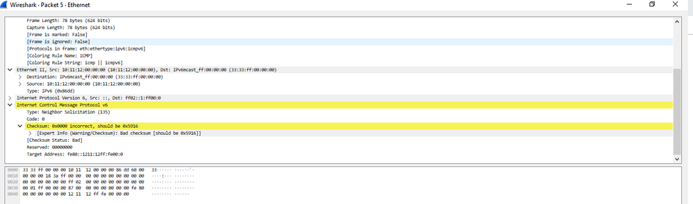

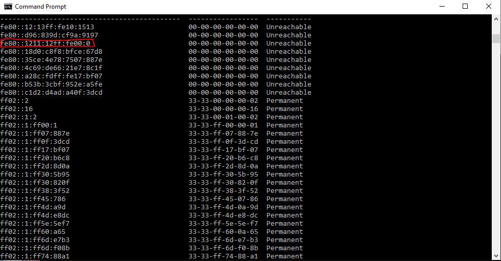

I did change the mac address to what you have mentioned above. Below is the screen shot of my IPv6 neigbors.
As you can clearly see that my s32k148 node with IPv6 assigned but I cant see any physical address getting assigned. It still shows 00-00-00-00-00-00. More important when I used Wireshark to check the status of neighbor solicitation messages I am seeing this.
neighbor_solicitation_message_ipv6.PNGThe checksum seems to be incorrect. I don't know whats wrong here.

saad_saeed
Hello Vlad,
The IPv6 issue is solved there is a macro LWIP_CHECKSUM_CTRL_PER_NETIF  in lwipopt.h. By default it is 1, now I have changed it to 0. Now, both link local Ipv6 address and IPv6 address achieved using SLAAC are working properly. The only problem I am facing now is that  my IPv4 address is not working. KIndly help me out with this issue.
