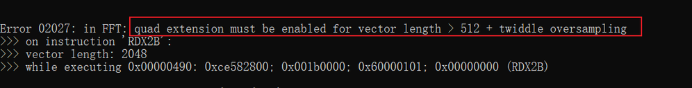

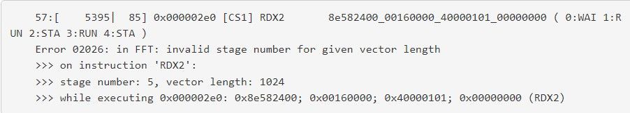

This SPT simulator error was output when I used S32DS 3.5 + Radar extension package for S32R45 version 1.3.0. And this error was NOT output when I used S32DS 3.4 + Radar extension package for S32R45 version 1.1.0.
instruction from RSDK:  rdx2.ind .cmplx .opsplit .noqext .noovs .round5 .nosft, SAMPLES_PER_CHIRP, WR_22, 0x1, 0x1, TR_0_0_0
 is this issue known before released? will it be fixed in the next Radar extension package version?
