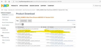

After receiving the evaluation board, we executed the following steps:
  1. Connected the evaluation board with a power supply. Configured the jumper as:
  1. We have used the example code for LED blinking provided at :-
  1. We checked the LED (D35) was blinking.
  2. We changed startup_cm7.s file (Port_Example_S32K396\Project_Settings\Startup_Code\startup_cm7.s)
  • We changed value of CM7_0_ENABLE to 0 and value of CM7_2_ENABLE to 1
#define CM7_0_ENABLE                (0)
#ifndef CM7_1_ENABLE
    #define CM7_1_ENABLE            (0)
#endif
#ifndef CM7_2_ENABLE
    #define CM7_2_ENABLE            (1)
#endif
#ifndef CM7_3_ENABLE
    #define CM7_3_ENABLE            (0)
  • Again, we reversed it to default values. (CM7_0_ENABLE to 1 and value of CM7_2_ENABLE to 0)
#define CM7_0_ENABLE                (1)
#endif
    #define CM7_2_ENABLE            (0)
#endif
  • We are not able to connect to the debugger and flash the project.
