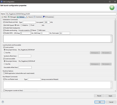

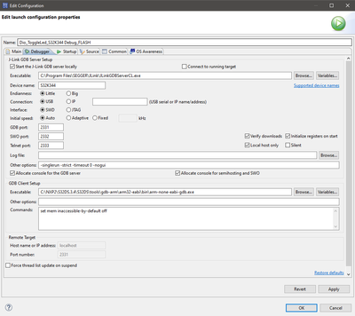

I have a S32K3X4EVB-Q257 evaluation board and have installed S32DS 3.4(Update 3) IDE.
Segger J link version is 7.60f.
I am trying to debug the Digital IO Led toggle example on the board through the IDE with Segger J link.
However I get the following error on debug window. I am not able to see the disassembly or place breakpoints.
My settings for debug are:

I can reproduce your issue. On my side - sometimes - especially with very first debug session - it works normally. But next debug session fails in the very same way like on your pictures. With PE Micro it works normally.
I didn't find the reason, it is probably something with Segger plugin - you can ask on Segger's forum.

xuchaochen
you need to use hard reset when using SEGEGR debugger. when just using soft reset, there are some regs not be reset.
