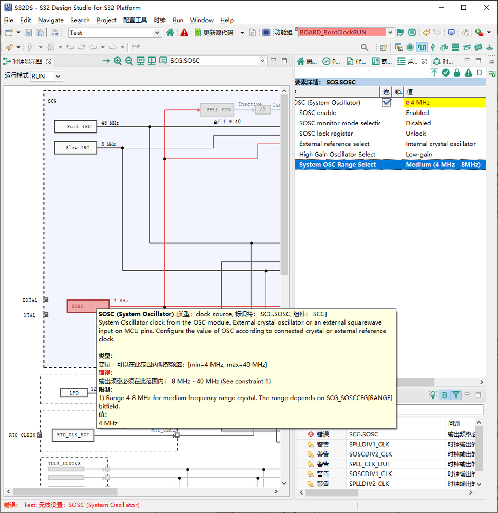

I'm using S32KDS to config the clock of S32K144.
I tried to set SOSC frequency to 4 MHz when SOSC range is selected as medium. However an error exists (as is shown in the picture). It says 'Output frequency must in the range: 8 MHz ~ 40 MHz (See constraint 1)' (translated from chinese). So, can 4 MHz oscillator be used as SOSC, or why shouldn't it be used?

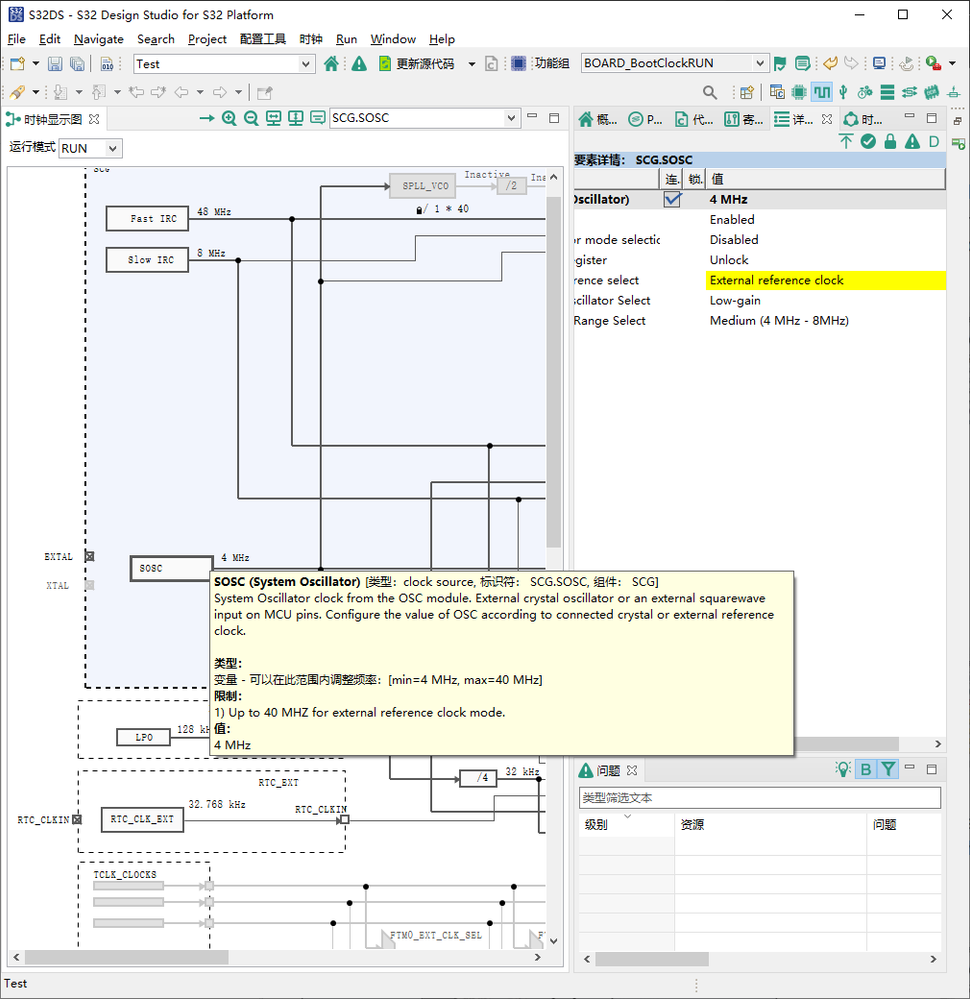

Also, when I set 'External reference select' to 'External reference clock', the error disappears. But I didn't find any related limits in reference manual (S32K1XXRM Rev. 14, 09/2021) or datasheet (S32K1xx Data Sheet Rev. 14, 08/2021).

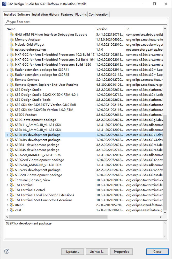

S32DS version: 3.5.2 230226 (Update 2)
Package version(not sure whether this package is used): S32K1xx development package 1.0.0

tom_zhaoxinping
This seems to be a bug in S32K1XX SDK RTM 4.0.1. In S32DS 3.4 + S32K1XX SDK RTM 4.0.3, this error doesn't exist. Attention, S32K1XX SDK RTM 4.0.3 can NOT be used in S32DS 3.5. So S32DS 3.4 is recommanded to use S32DS 3.4 instead.
Thanks to Shen for help.

tom_zhaoxinping
As the error disappears when I set 'External reference select' to 'External reference clock', I guess 'SOSC Range' doesn't matter when using 'External reference clock'.

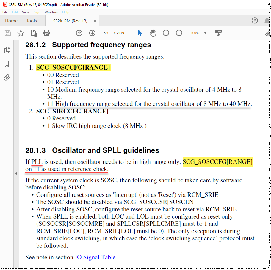

Robin_Shen
Hi zhaoxinping,
Do you need PLL
If PLL is used, then oscillator needs to be in high range only, SCG_SOSCCFG[RANGE] on 11 as used in reference clock.
When SCG_SOSCCFG[RANGE]=11 , frequency of selected crystal oscillator should be 8 MHz to 40 MHz.
Robin

tom_zhaoxinping
Hi Shen.
Thanks for your reply.
Actually, I used a 8 MHz OSC for PLL. But to prevent my colleagues from making a mistake in the future, I want to know the reason and write a comment in my design. Also, if this is a bug in S32DS, maybe I can report to NXP to fix it. (But as I have known S32DS for a few years, I'm not sure if this is a bug.)
