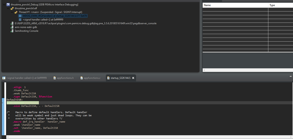

sripav-7
Hi Jiri.
I did the same thing as you said to my project and it doesn't work for some reason. I get this while debugging:
Additionally, I also get these warnings:
4,563 Views
jiri_kral
your program ends in exception for some reason (watchdog/clocking?). Are you able reach main function? Just try to figure out when the exception occurs. Invalid paths warning is okay - you can remove them from project settings. If it is possible you can share your project, I'll look at it.

sripav-7
It isn't reaching the main function for some reason and I don't know where the problem is. Here is the project:

jiri_kral
you were using startup and linker files for S32K144. Here is step by step howto change package layout/family:
HOWTO: Change the CPU Derivative in an SDK-Based Application Project
In attachment is updated your project - unfortunately I have only S32K142 100 pin version and tested your project with this part (works okay - I can get into main). In the attached project is package switched back 64 pin version with fixed paths and so on - but untested with HW.
Jiri
4,563 Views
sripav-7
Thank you so much. I created a new project and reconfigured it a few minutes before you posted this. It works now.
