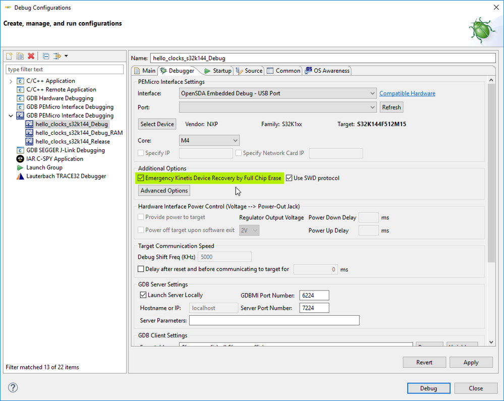

jiri_kral
you can try  Emergency Kinetis device Recovery in debug session settings:
Jiri

香龙朱
Hi, Jiri
Thanks for my question.
I have three devices can't be Erased.I tried this method, it is effective on one device. but other two devices have no effect.

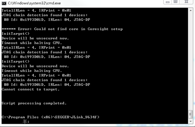

I also tried other method. I refer to thread1thread2 and document. I also use script "erase_all_pin.jlk" with j-link.
but I can't erase my other two devices.

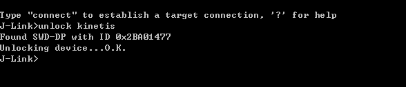

I used "unlock kinetis" command, It tips me O.K. but I can't connect my device with J-link or OpenSDA or P&E.

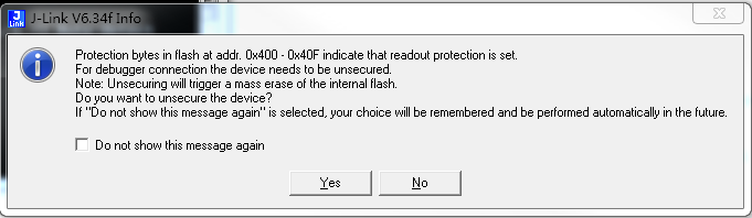

I used the script "erase_all_pin.jlk", it tips me so many "Protection tip".
At last it tips me a "Cannot connect to target".

jiri_kral
your device has probably also disabled mass erase. With this settings there is no way back (device is secured, mass erase disabled). and only soldering iron can solve it.
