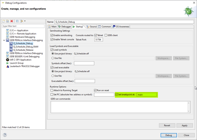

In your project is on that address 0x410 Reset Handler and program already passed through. Break point on main() function is set by default in Debug session config:

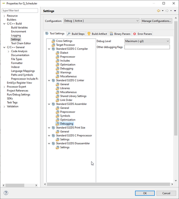

It is also possible that you have disabled debug info for assembler:

on 0x410 address is reset handler written in Assembly language. By default - first breakpoint is in main() function  and as you can see on your screenshot - the program is stopped there - address 0x798.
I tried your program - and there is no issue on my side. When you close the 0x410 tab and restart your debug session, is the 0x410 tab shown again?
