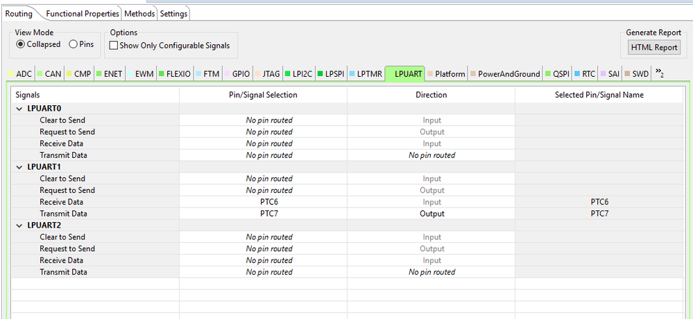

stanish
Hi Kong,
I don't see anything obvious on the snippet you posted.
I'd suggest you to check:
* if your pinmux  for Rx/Tx pin is correctly configured. (see below example valid for LPUART1 - OpenSDA UART)
* can you send character from MCU -> PC?

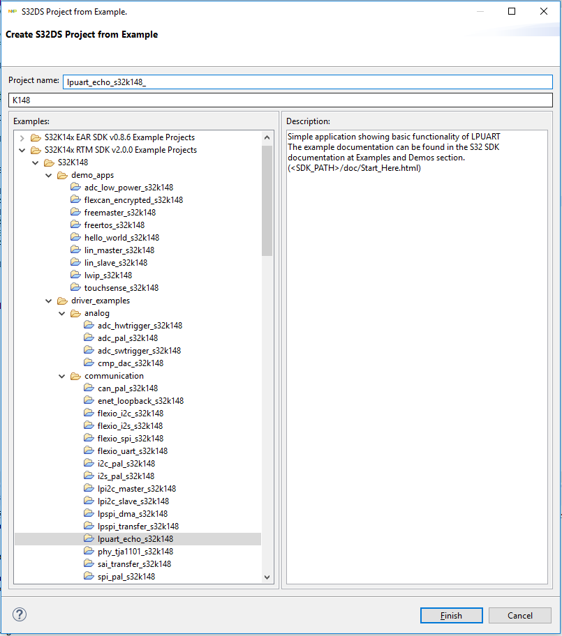

* see the SDK example lpuart_echo_s32k148 as a reference project
Hope it helps.
