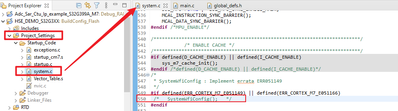

Daniel-Aguirre
We have received the following update:
It may be caused by the debugging port being closed. Please delete the command shown below and rebuild.
Please, let us know.
2,133 Views
wenyunhao
 Thinks for you replay, I'm so sorry to tell you ,When I comment the function"SystemWfiConfig" in line 550 of the file system.c according to what you said and then debugging with attach,But It still reported an same error as before. Did i misunderstand what you said about "delete the command shown below and rebuild" ? If so ,how should I solve this problem correctly ?

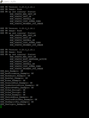

Daniel-Aguirre
Thanks for your feedback. Looking through the HSE_DEMOAPP_0_2_16_1 Read me, we see the following information is shown [Page 11]:
Which seems contrary to what the internal team mentioned. Still, we tried with those specific versions and we are able to debug the application correctly:
Once thing is that we first need to select the "S32Debug" configuration. This will fail, then we select the "Load_Symbols" configuration, then we are able to debug no problem:
We see the following outcome on our console:
In which, until the 3rd print, we see that the debugger was set as active, then we are able to continue no problem.
