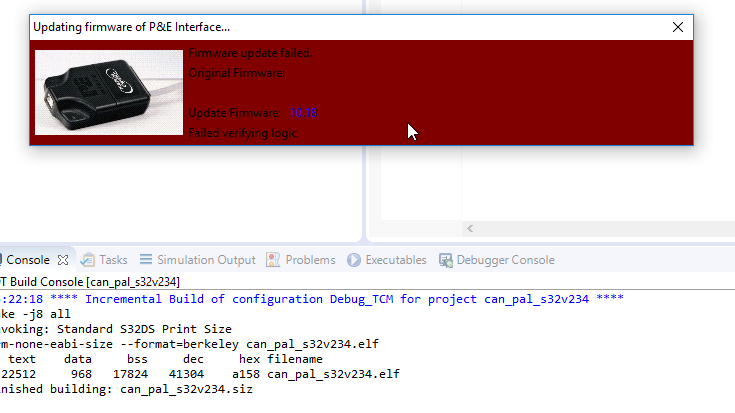

I tried your scenario - and ended in the same state. But mine issue is related to some PE Micro issue. It looks that firmware in PE Micro Multilink can't be updated - for some reason:
Are you facing the same issue?
Jiri

jiri_kral
update doesn't work, but it looks that it is my local (probably network?) issue. Glad to see that you solved your issue.
