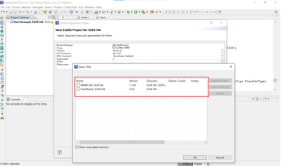

Dears,
      I am using S32DS3.4 to develop K144, and I want to make a new project using "File->New->S32DS Application Project", but when I choose the SDK, I cannot find the standard SDK for K1(such as "S32K1xx RTM SDK.....", although I have installed it by the related  " .exe" file downloaded from NXP offical website ), detailed picture as below, the only 2 sdks shown are "AMMCLIB_S32K14x" and "FreeMaster_S32K144",please tell me how to resolve it? thx!

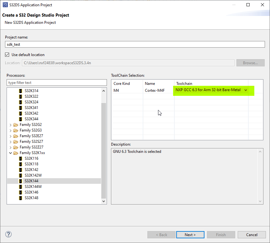

jiri_kral
yes, SDK is built with gcc v6.3. If you choose higher version, SDK is not available.

jiri_kral
do you have installed S32K1xx SDK package?
If So, please make sure that you choose correct toolchain in New Project Wizard (gcc v6.3):
2,038 次查看
Fidel
if the tool chain is wrong ,then the SDK cannot be found in the next page?
2,037 次查看
jiri_kral
2,034 次查看
Fidel
hi Jiri,
        I checked what you said , and just like you said , with different GCC version ,different SDK showed up, thanks a lot~
