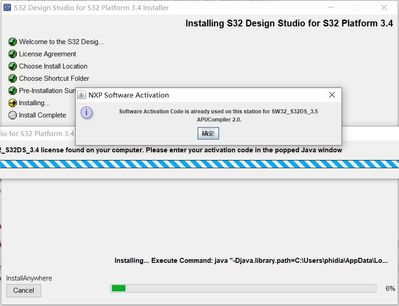

I have installed S32DS3.5 in my PC,now i wanna intall S32DS3.4 in it,but it show a error:the activation code is used by s32ds3.5. How can i install the two version? thanks.

you are probably using wrong activation key. What is the key used for activation of S3DS v3.4?

Activation Code: 0A85-E852-148E-082D ,I used this activation code to successfully install S32DS3.4 last month,but this week i uninstalled  S32DS3.4 and successfully installed S32DS3.5 (used this activation code). Now,I wanna install S32DS3.4 and 3.5 in the same PC. please help,thanks.

It seems the activation code you are using (0A85-E852-148E-082D) has been migrated to work for S32DS 3.5, so now it cannot be used for S32DS 3.4. For S32DS 3.4, you should use the activation code you have on your account for the S32DS 3.4, CBE1-1765-9C4C-C004.

thanks a lot,I have installed S32DS3.4.
