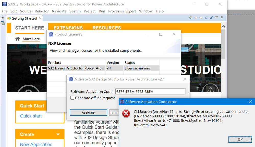

When I open my software, it prompts that the license is missing. The information is as follows:
S32 Design Studio for Power Architecture v2.1
Your license file is not active or has already expired. Please click the Activate button and enter a valid Activation key.
My license Info. is below.
Order NumberS32DS-PA_170180597
Activation Code:6376-E58A-87E3-38FA
Version Description
2.1 S32DS-PA_v2.1 (View EULA)
Could you help extendding the license?
Thank you. best regards.
759 Views
jiri_kral
your S32DS license has been extended.
742 Views
peiyuefei
Thank you. But why can't I still activate the software?wechat_2025-07-11_092105_777.png
725 Views
jiri_kral
it looks that you S32DS is not able establish connection to License server. Please try the offline activation - https://community.nxp.com/t5/S32-Design-Studio-Knowledge-Base/HOWTO-Activate-S32-Design-Studio/ta-p/...
