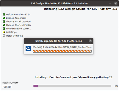

I also failed to install S32DS.3.4_b201217_linux.x86_64.bin in Ubuntu 20.04:
the installer process seems stalled and sometimes the host OS Ubuntu 20.04 will be suspended( OS not responded with keyboard or mouse)  by the S32DS.3.4 installer process.

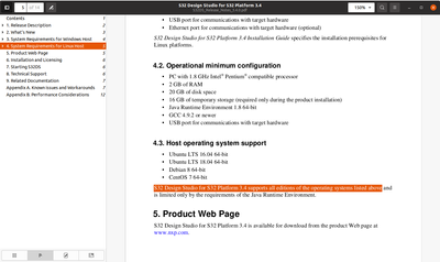

It seems "S32 Design Studio for S32 Platform 3.4" doesn't support Ubuntu20.04 officially according to <<S32DS_Release_Notes_3.4.0.pdf>>
Hope this issue could be validated and fixed by NXP expert.

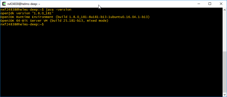

jiri_kral
I already install S32DS for ARM on fresh installation of ubuntu 18.04 - only what I need to do is install openjdk runtime enviroment - exactly by the same way as Dimitry suggested:
sudo apt-get install openjdk-8-jre
My java version:
nothing else is required for installation. Here is list of 32bit libraries required for runtime:
Hope it helps.

b48014
Design Studio Installer doesn't support Ubuntu 18. Please double check requirement in the Release Note.
Anyway, please try to use java 1.8

b48014
Please note that Java Runtime Environment 1.8 64-bit must be installed separately to install Design Studio.
BR,
Dmitry
