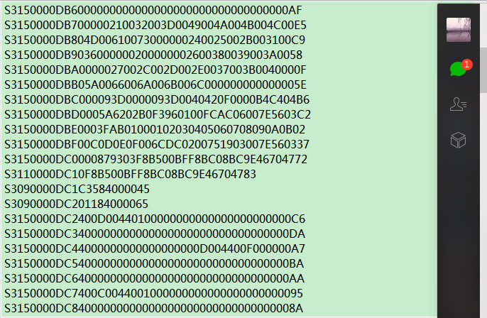

    I use s32ds to generate s19 file, but when l use s19 file to upload to s32k144, fault occur, if someone know how to solve it ,example as setting s32ds or setting s19 file to change s19 file becoming standard and uniform.please tell me the method ,thank you.

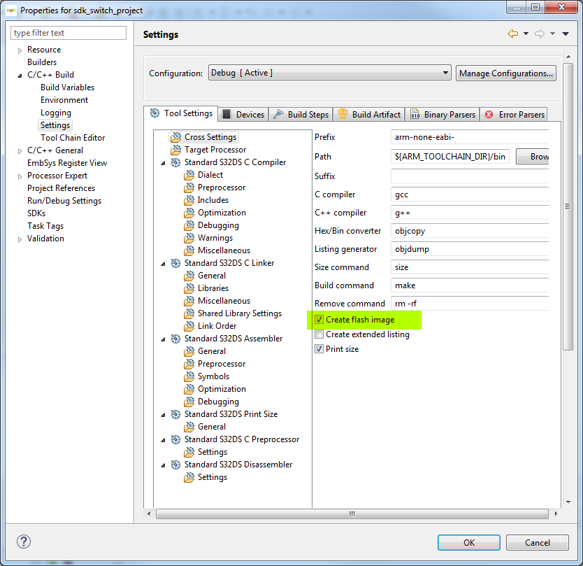

文辉王
I just contact the S32 compiler, would like to ask you a question, how can I set up to generate ". S19" document?
Wenhui Wang
5,939 Views
jiri_kral
right click on project name -> Properties -> Settings
Jiri
5,939 Views
文辉王
Sorry, I was wrong, just the way you set it is correct. thank you very much for your help.

文辉王
I set it according to your method, but did not generate ".s19" file. Is not also need to set up other options?

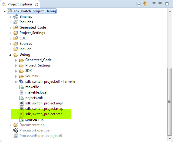

jiri_kral
You can find the .srec (s19) file in Debug folder inside your project:

jinshuaixu
Contributor V
Hi,Kral
      firstly,thank you for youy response. my s19 file is correct, but it as app file to programme to s32k144. In my project ,use boot and FLEXCAN to programme app file.
     If s19 file is not align,l will calculate it to let s19 file align,my app file has 200k ,it is too much ,so it is will spend much time.if generate s19 file is align,it will be good for me.so l think ,through setting s32ds software to access my desired results. thank you.
