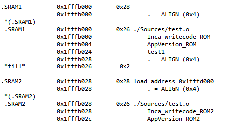

     Recently ,l find s32ds generate .elf and .map file address  is offset,set below picture
      In project ,l have setted SRAM1 area form  0x1fffb000 to 0x1fffcfff,SRAM2 area is form 0x1fffd000 to 0x1fffefff.
      l know that the variable  "Inca_writecode_ROM2" load address 0x1fffd000, but l want let .elf file address do not offset.Because the next  l will use "Vector ASAP2 " software to import .elf file,so if address is offset ,it will cause software read data is error.

       l solve this problem through change the link file of project.
