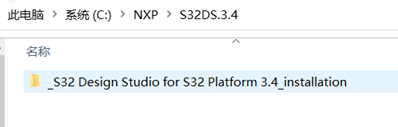

after run S32DS.3.4_b201217_win32.x86_64.exe and install finished, cannot find icon.
In  the install path, no executable file.
タグ(1)
10 返答(返信)
5,316件の閲覧回数
mikedoidge
Hello Zhou Mo,
Please provide the installation log file located in the folder shown in your image.

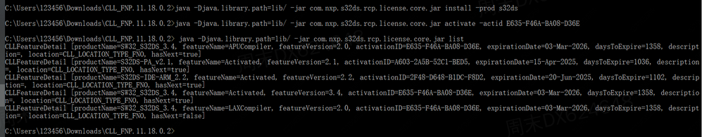

The log file is showing that the installation did not complete successfully. The issue occurred when installing the license. The license server provided the license, but the licensing tools failed to install properly on your PC.
Here is what I suggest:
I have attached a package of files which will allow you to update the version of FNP on your machine. There is a file 'help.txt' included in the package that provides the command line instructions to be followed to do 2 things:
1) Install the updated FNP to your PC
2) Activate your S32 Design Studio license
It is important to perform both steps. By activating the S32 Design Studio license through this method, we can add the license to the trusted storage on your PC. Then, when you execute the S32 Design Studio installer, the trusted storage will be checked for a license. The license will already be present, so the activation process can be skipped by the installer and the installation can be completed successfully.
I hope that this will resolve your issue. Please let us know if you have any further difficulties.
Mike
5,279件の閲覧回数
ZHOUMO
installed, still go wrong.

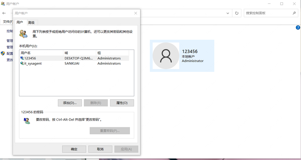

From the latest log file, it appears there is some issue with permissions. Could you please confirm if the user account which is applied when the S32DS for S32 Platform is installed (123456) is a member of the Administrators group?
Mike
5,258件の閲覧回数
ZHOUMO
111.png123456 is a member of the Administrators group.
