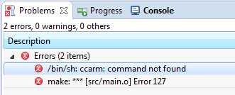

after starting the compile session i got the following error on several files:
/bin/sh: ccarm: command not found
After that the build is terminating.
I am using GHS ARM Standalone Executable Toolchain

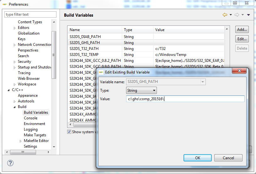

Hi Gabor,
you probably observe this error.
In order to build GHS based project in S32DS you should setup the build variable S32DS_GHS_PATH.
Go to Window -> Preferences -> C/C++ -> Build -> Build Variables (Show system varaibles) and enter the ghs tools path.
Note:  If you switch your workspace to a new one - you should re-enter this path again.

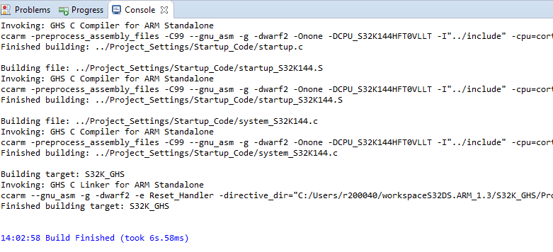

Then you should be able to build GHS S32DS project:
Hope it helps!
