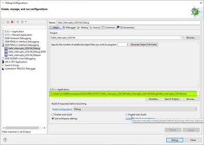

I'm using the S32DS for ARM 2018.R1 and could not download the s-record file to the S32K146.
I saw the guide at the post below, and tried to follow all three cases. However, I couldn't do it with the 1st way and 2nd way.
https://community.nxp.com/t5/S32-Design-Studio-Knowledge-Base/HOWTO-download-separate-elf-srec-hex-f...
Would you please review the failure message attached, and let me know what the problem is?
James

actually the only difference between .flashing srec and .elf files is selecting .srec instead of .elf file in debug configurations:
There are no additional special steps. The - s-record file is not an executable file (in meaning what is .elf or  .exe format)  - it is content of memory represented by text file format.
