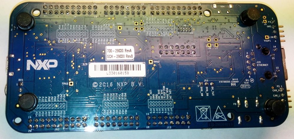

nxppower912935
Hi all,
which boards are affected?
Mine:
700 - 29030 RevA
SCH - 29030 RevB
L330160167
stanish‌ do you have any news from your side?
Ludwig

stanish
Hello Udit,
Could you please indicate which revision and S/N of the board you have?
There should be some labels at the bottom side of the board:
Thanks!
Stan
6,062 Views
uditsalunke
Stan,
for my board its two labels at back side reads as below
700 - 29030  RevA
SCH- 29030 RevB
L330160087
Udit
