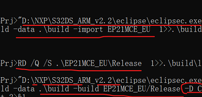

wesleyxie
@turgaykale
I use "-build" option instead of "-cleanBuild", and remove the build output directory of the selected configuration before the command with "-build".
for example:
