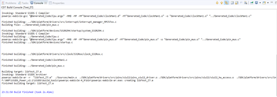

Hello all,
When use S32DS to build the demo from S32DS Library project, it can't generate .elf event if there is no error showed at the Console as flowing:

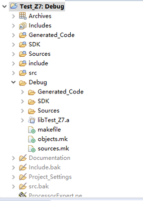

But there is no .elf generated at Debug file as following:

the build target of Library project is library archive - libTest_Z7.a in your case. If you like to build an executable - .elf file - you need to create S32DS Application project.
Jiri
