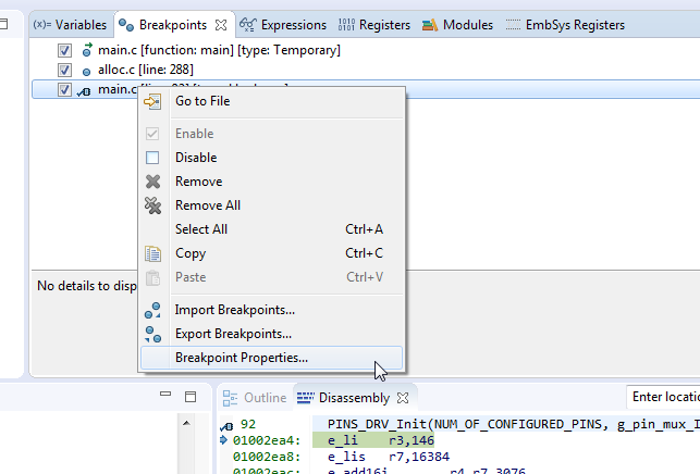

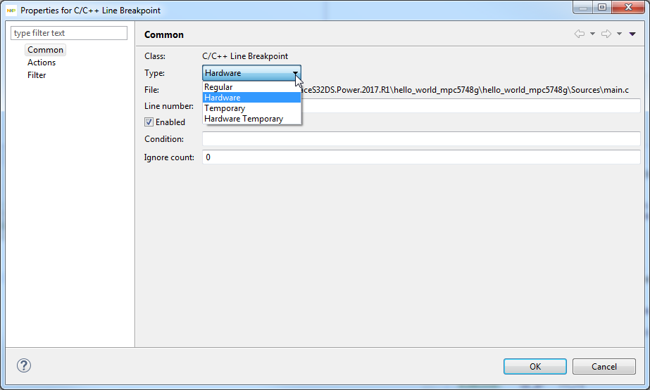

I figured out that breakpoint type can be set in breakpoints view and breakpoint's properties:
You can choose from couple breakpoint types - including the HW one:
The question is how good is this feature implemented by PE Micro. I never used it with PE Micro.

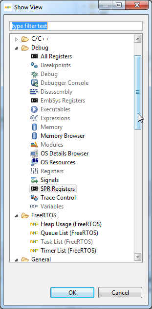

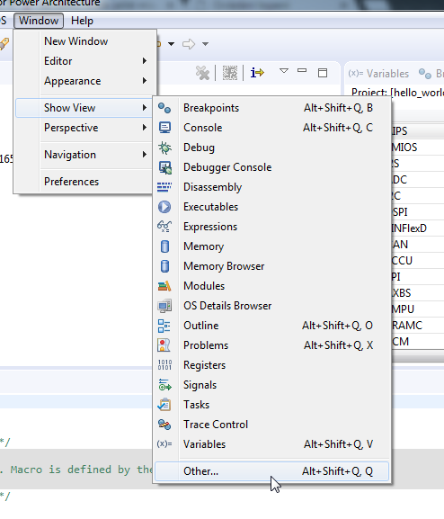

SPR view can be selected in active debug session by clicking on Window -> Show View -> Other
there is SPR view in debug folder:
You can check current value by doubleclick on particular register:
Hope it helps.
