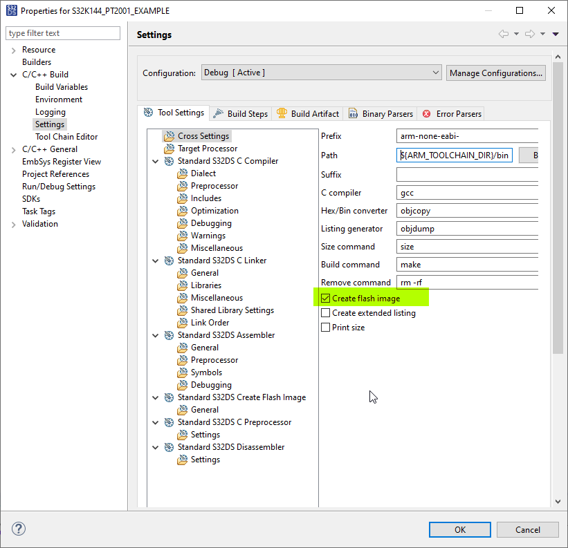

Hello, I'm trying to build the example "S32K144_PT2001_EXAMPLE" posted here https://www.nxp.com/webapp/sps/download/license.jsp?colCode=S32K144_PT2001_EXAMPLE
and I get a couple errors.  /bin/sh: gcc command not found, and  [makefile:83: S32K144_PT2001_EXAMPLE.elf] Error 127 S32K144_PT2001_EXAMPLE m
Ive tried searching for help with no luck.  I'm new to S32DS, how can I fix this?  thanks.
I'm using S32DS for Arm 2.2

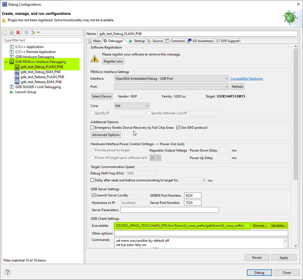

I also had a problem with the example code above, so it worked very well when I followed the measures described. However, when debugging, Error with command: gdb --version
Cannot run program "gdb": Launching failed
The phrase was printed out and faced a new problem. Can you tell me the solution for this? Thank you.

please make sure, that you are using the correct gdb executable prefix/suffix and debug configuration for your debug probe. Settings bellow is for PE Micro:
${S32DS_ARM32_TOOLCHAIN_DIR}/bin/${arm32_cross_prefix}gdb${arm32_cross_suffix}

Thank you very much. Thanks to you, it's settled. Have a good day

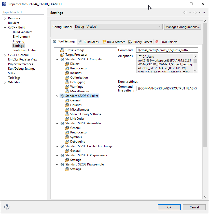

The project is for very old S32DS for ARM v1.2. To migrate it to S32DS ARM v2.2 you need to change some settings in project example -  please change gcc to ${cross_prefix}${cross_c}${cross_suffix}  in Project Properties -> Settings -> Standard S32DS C Linker :
Add create record option:

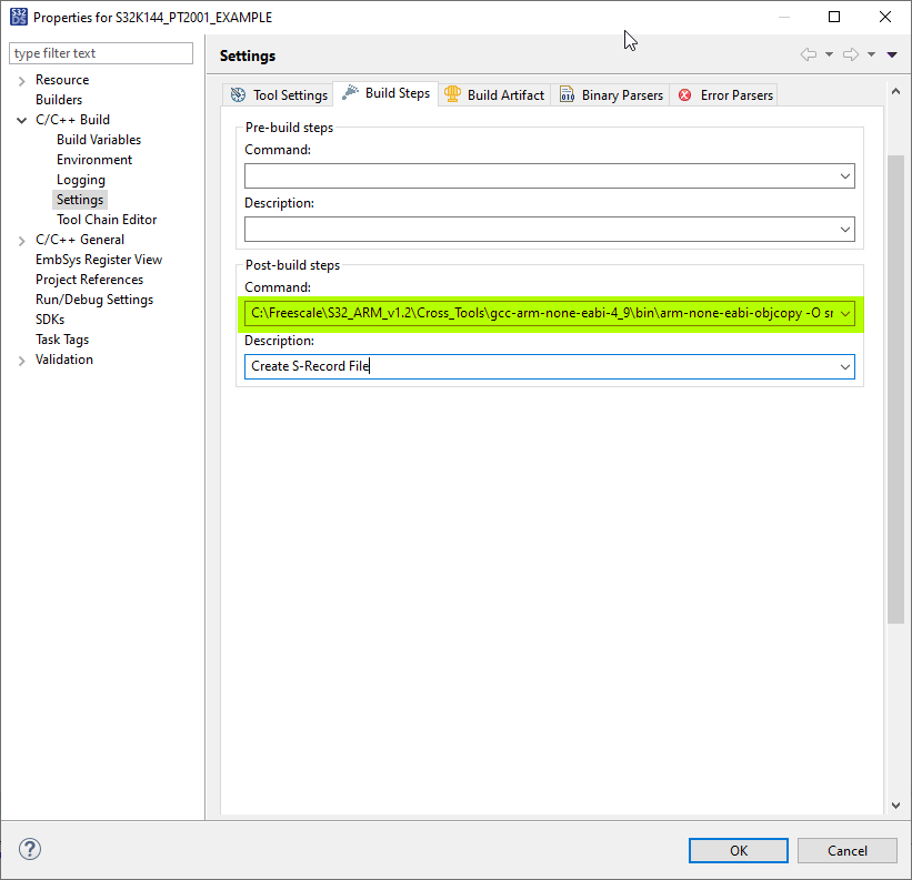

And remove post build step for S-record generation:
