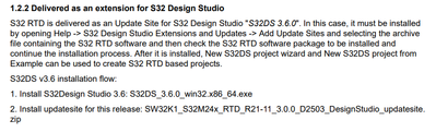

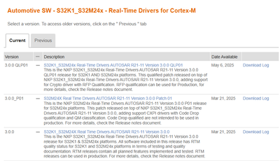

About the SDK, I imagine you mean the Real Time Drivers (RTDs). I would recommend installing the following packages, which are the latest I can see:
Please follow the recommended installation order, this is: 3.0.0 -> 3.0.0 P01 -> 3.0.0 QLP01.
You can follow this steps to install them [page 1, S32K1_S32M24x Real-Time Drivers AUTOSAR R21-11, Version 3.0.0, Release notes, 21 March 2025]:
If you have more questions please create a new post since this already has an accepted reply.
