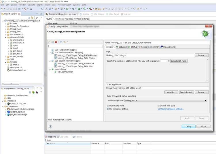

Now I am working on S32K114 EVB + S32DS for ARM V1.2. The SDK  0.8.1 has also been installed on my computer.
When I connected the EVB to computer via USB port and tried to debug the sample given by the SDK, it failed with an error.
For example, I created a Project from S32DS : File > New > New Project From.. > blinking_LED-s32ds-gcc, and successfully finished the "Build Project" and "Debug Configurations" process, if then I click "Debug", an Error are shown as follows:

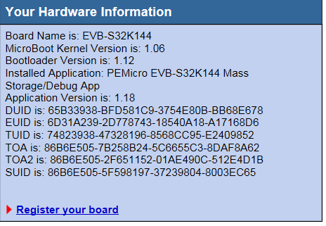

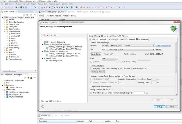

The S32DS is running under Win7 32bit, and the Debug configurations and EVB hardware information are as follows:
In addition, even if I create an empty project by "File > New > New S32DS Project" and do "Debug", the same Error occurs.
Have anyone met such problem, and could give some suggestions?

I had a similar situation, but in the Debugger Config, I needed to sign-up (license) and enter my E-Mail to enable the feature.

Basically, for the very first time I was in the tab Debugger, there was an additional exclamation mark sign (yellow) asking for registration. I entered my E-Mail and it disappeared while enabling the feature.
Initially, I had the same error as Zhao '...failed to launch GDB server...' so that I why I investigated and after registration under the Debugger tab, the error message disappeared.
