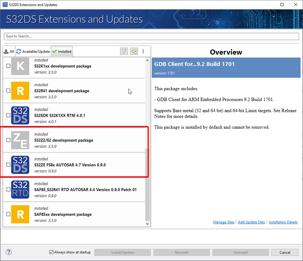

After having created a new appl. project, selected IVT config tool.
Somehow S32DS refuses to let me select my newly created project with error "MCU is not selected".
How to select the MCU?

jiri_kral
config tools required installation of RTD:
