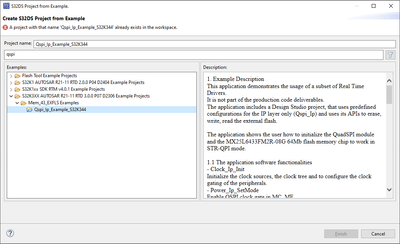

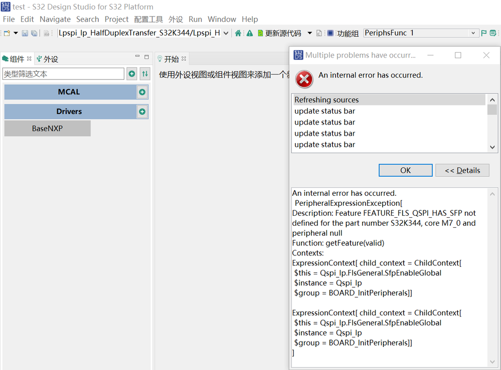

S32DS 3.5_RTD3.0.0_S32K344_添加QSPI出错
应该怎样才能正确添加QSPI呢?
1,392 Views
Julián_AragónM
Hi @harryoceana,
This issue is probably caused by a faulty installation. Could you confirm the RTD package is installed correctly? Try importing the Qspi example firstly:

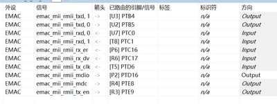

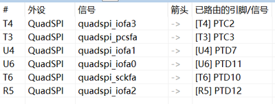

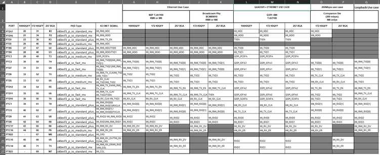

https://community.nxp.com/t5/S32K/S32K344-RMII-QSPI/m-p/1416828
In this post, can't RMII and QSPI be used at the same time, and can't 257BGA package be used at the same time?
Can RMII and QSPI be used at the same time if the chip pin meets the requirement of using RMII and QSPI at the same time?
1,330 Views
Julián_AragónM
Hi @harryoceana,
As you mentioned due to the pad type support RMII + QPSI is not possible for S32K344 devices. It is the same as it is not related to the package. You can look at the tab in the "S32K344_IOMUX.xlsx", where the ethernet use cases are listed:
