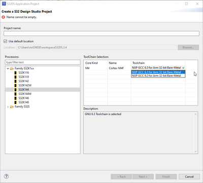

HI Team,
I installed S32DS.3.4 on D:\NXP.  and
I installed S32_SDK_BETA_0.9.0 on D:\NXP.
But S32DS.3.4 can't find this SDK when running 'Create a New Application Project', Pls check screencap as attached.
any  comment?

Hi @Lambert ,
To install the SDK integrated into S32DS, you must use the SDK file which contains '...updatesite.zip' in the name. Otherwise, you would need to manually add the SDK to projects individually in S32DS and the built-in integration support would not be present.
The SDK is released in 2 forms: as standalone version (filename ends with .exe), and in DS integration version (filename has ...updatesite.zip). If the DS integration version is not available, please contact the SDK team for more information.
Hope that helps,
Mike

Hi Lambert,
which toolchain you selected when you created new project?
