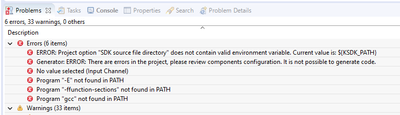

I downloaded the project "S32K142_EVB_JumpStart_Firmware" from the NXP site. When I try to compile it with S32 Design Studio for ARM 2.2, I get the following error:
I tried to compile the same project with S32 Design Studio for Platform, the problem is exactly the same.
Info: in both cases, I have uploaded the project by the menu "File > Open Projects from File System...".
Can you help me resolve this issue? Thank you very much.

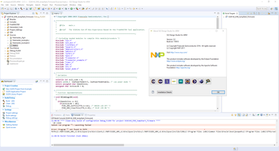

Hi Julián,
I finally managed to install version 2.0 of S32 Design Studio for ARM using my admin account. I imported the project "S32K142_EVB_JumpStart_Firmware", but the generation results in the same error as with version 2.2. Here is the screenshot:
In case this could be useful to help me resolve this problem, the installation log file is attached.
Once again thank you for your help.
Bernard.

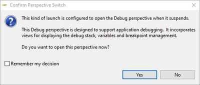

yes I tried to follow "Q&A of S32K1x FreeMASTER JumpStart Project", but everything is not working properly. In the "4.5 Set Up Debug Configuration" chapter, the "Apply" button is not active, only the "Debug" button is accessible. When you click on it, an error message appears.
When I proceed:
Click on "Yes":
it seems that we can debug (Run, Suspend, Resume, Step Into, Step Over, Step Return, Terminate… are available), but we do not have access to the source files, it is not viable. I don't know where the indicated path is found ("D:\GIT\033_jumpstart_sw\S32K142_EVB_JumpStart\S32K142_EVB_JumpStart_Firmware\Debug_FLASH/../Sources/main.c"), I looked in the paths specified in the project properties, this path is not specified anywhere, and it does not appear in the source files (according to what I could find).

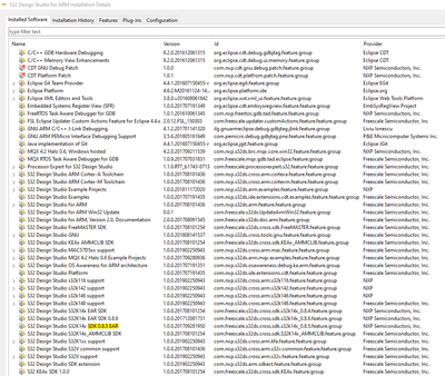

Yes, I updated "S32 Design Studio for Arm® v2.0 Update 2 – S32 SDK 0.8.5 EAR & MQX", here are the installation details:
I reconfigured the baud rate to 115200 as indicated in chapter 4:

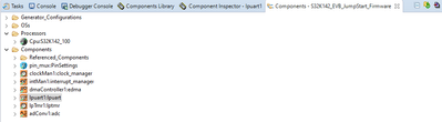

and then I clicked Generate Processor Expert Code:
The problem is still the same.

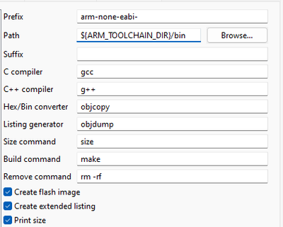

I had already read the community posts, but the only information that seemed interesting to me would be a command line exceeding 8192 characters and that the GNU ARM Eclipse build tool would have to be updated. The proposed version seems obsolete. I don't know how to check which version I'm currently using and I don't know exactly what to update.
Best regards.
Bernard

Regarding to not having access to the source files when debugging, when you proceed with debugging with errors in the active configuration, the debug perspective does not function properly.
Just to confirm, there has been no modification to the example after importing, correct? I am asking this because I can build the example correctly with no modifications.
Julián

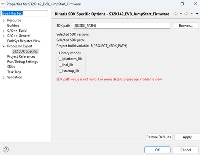

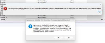

When importing your project, S32DS throws me many errors in configuration for the SDK, as such:
As well as some path problems;

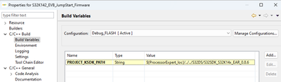

This seems to be a problem with the project configuration for the KSDK specific path:

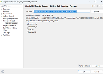

Could you try installing S32 Design Studio for Arm v2.0 - Update 3, which includes S32K14x_EAR_0.8.6? This seems to fix the SDK path value issue:

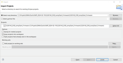

Once this update is installed, please try importing the project I have shared into the workspace, the same way you already explained in the original post: Import > Existing Project Into Workspace > Select archive file > Finish

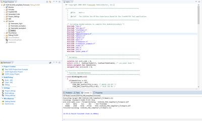

Once imported, move the Baudrate configuration first, generate Processor Expert Code which should prompt a "Track Changes" window:

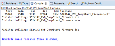

After accepting and waiting for the code to be generated, the project should be able to be built:
If this is still not the case, I would suggest reinstalling S32DS, and only adding update 2 and 3, and testing these steps again, as your workspace or installation may have been broken.
I have also added the build log, and some project properties for the C Build, as you error seems to be related to the makefile, so you can compare:

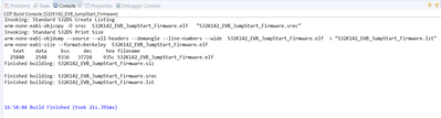

I have installed S32 Design Studio for Arm v2.0 - Update 3, which includes S32K14x_EAR_0.8.6. I then updated the project configuration for the KSDK specific path as you requested. The operation went well.

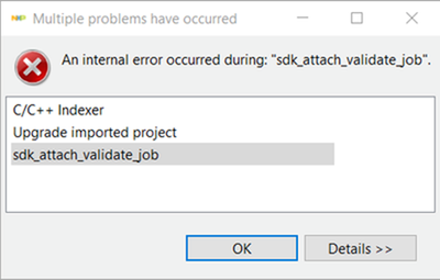

I then wanted to import the project that you just shared with me, but this is not possible because projects cannot be imported when they already exist in the workspace. So I deleted the old project from the workspace so I could import the new one.
but the following error appeared:
No action is then possible, an error systematically occurs.
So I decided to uninstall then reinstall S32DS and add update 3:
After that, I built the project, there are no more errors but there are still 7 warnings. I will now try to resolve them.
Bernard.
5,680 Views
Julián_AragónM
Hi @Bernez,
I'm glad there are no more errors when building. You can still flash and debug the code if there are just warnings in the workspace.
I hope you found this helpful.
Julián
