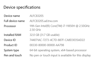

This issue has been found in all the PCs of the customer. After upgrading S32DS to following version:
S32 Design Studio for S32 Platform
Version: 3.5
Build id: 230226 (Update 2)
Everything becomes too slow, to the point that just to edit one character in the code hangs the computer for a couple of seconds.
The Device specifications of the customer machines are:
Which should be OK.
Do you have any more reports in this direction? or Any tips to help the customer here?

We have a working S32DS v3.5 with the *.ini file modified to use up to 4GB of our RAM, we are not seeing any slow character processing nor compilation struggles. Could be that the customer is using applications with heavy RAM usage which in the end is not infinite.
Is S32DS slow on its own? Or when they are using additional applications? Some applications could use up to 16GB of RAM, which if 2 are open, then all their RAM budget is gone.
Please, let us know.

You could add more RAM to the application by modifying the "s32ds.ini" located in the following path:
"C:\nxp\S32DS.3.4\eclipse"
The variable "Xmx" should be the max RAM that can be used by S32DS, you could increase the value, with caution.
