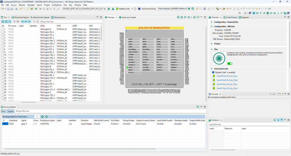

I tried both importing an existing example and generating a new application project using RTD 6 QLP01 for S32K396.
The graphic display of the pins tool looks great for the BGA package, but after changing the package to 176LQFP, there are no pins on the top of the LQFP package (all are on left, right, and bottom).
Is this something that is planned to address, or is this an issue with my installation?

Robin_Shen
A bug report has been submitted to the S32 Design Studio team. They have confirmed the bug and will fix it in a future release.

Thank you for reporting this issue.  I have reported this issue to the S32DS team and will let you know once I receive a response.

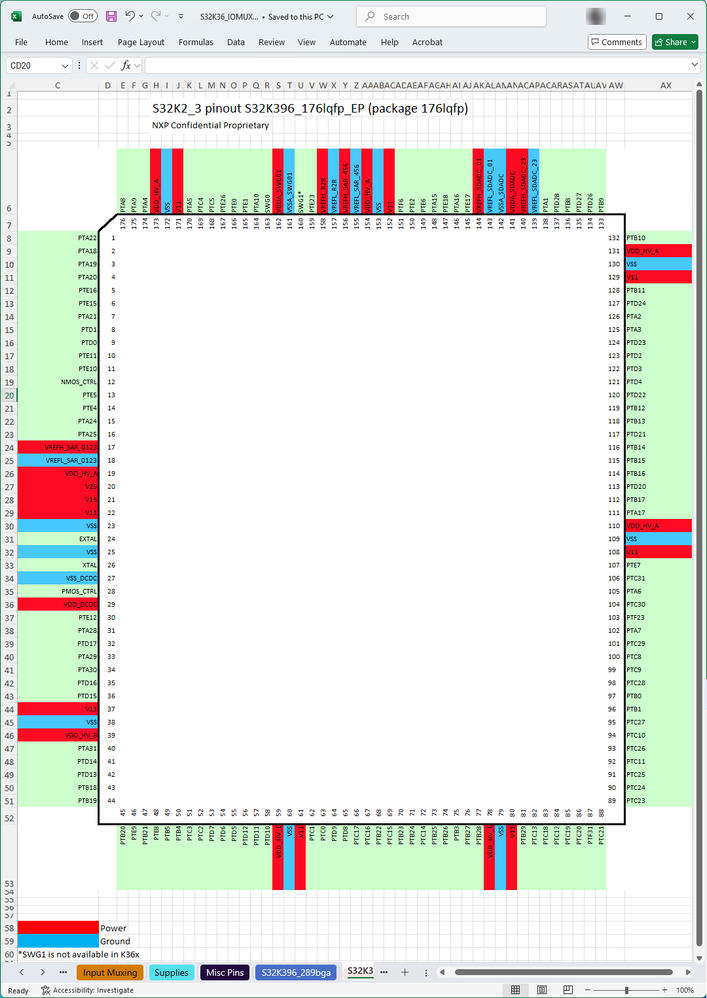

The pin positions are currently displayed incorrectly. Please refer to the S32K396_176lqfp_EP of S32K36_IOMUX.xlsx file in S32K396RM (Rev. 4 11 2024).pdf for the correct pin positions.
Package view of Pins Tool on S32K3 RTD 6.0.0 QLP01 shows an incomplete S32K396 pin location.png
