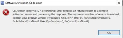

fabriziotorrero
I have already tried but this message appears
1,213件の閲覧回数
jiri_kral
I suggest to left the license expire automatically. I already returned licenses from your account, the license record is stored in local trusted storage in your PC.
If you like to remove local license - make backup of c:\ProgramData\FLEXnet\ (the folder is hidden by default) and delete content of that folder.

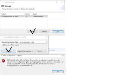

I have a similar problem with the S32DS_ARM_v2018.R1 with the license 3C5C-8F28-2B07-3102 (see image below).
Is it possible to restore it?

fabriziotorrero
I tried to insert the license, but the result is always the error indicated in the previous image.
1,176件の閲覧回数
jiri_kral
Looks that you are using activation key from your colleague (no problem). I extended S32DS license for Dario as well.
