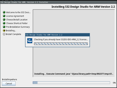

I'm trying to install the S32 Design Studio for ARM v2.2 on Ubuntu 21.04. But the installation gets stuck at the License Validation screen. It gets stuck here indefinitely and doesn't ask me for the activation key.
I have installed jre1.8.0 if that helps.
Here's a screenshot of what that looks like.

Hello @zycamedis,
The S32 Design Studio for Arm 2.2 was only tested on Ubuntu 16.04, probably there is some difference that causes this issue. Is it possible for you to use S32 Design Studio for S32 Platform 3.4 instead? It supports Ubuntu 16.04 and 18.04.

You're awesome! The 3.4 installation worked perfectly! I wonder why I didn't get the option until i specifically searched for it.
Zyc!
P.S.: For anyone else with the same problem, follow every step of the long installation guide very carefully. Including installing older packages where required.
