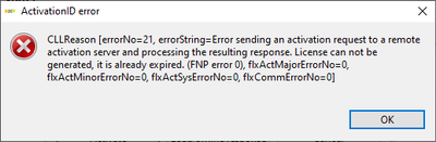

Bryan9
@mikedoidge,
I tried it, but the license menu shows me the following error:

mikedoidge
Hello @Bryan9,
I checked the license server, there was one user able to re-activate with updated expiration date. It only gives me an encrypted machine ID so I cannot tell who. There were a number (about 20) of expired licenses from prior activations. I manually returned them so now there is just the 1 license. Try again. If that doesn't work, your trusted storage may be corrupted and needs to be re-initialized. To correct this:
Windows host:
-> Delete 'C:\ProgramData\FLEXNet'
This folder may be hidden by default, so then it would be necessary to change Windows Explorer settings to show hidden items.
Linux host:
/usr/local/share/macrovision/storage
Mike
9,838 Views
Bryan9
Hi @mikedoidge,
Works now.
Thank you so much for your help!

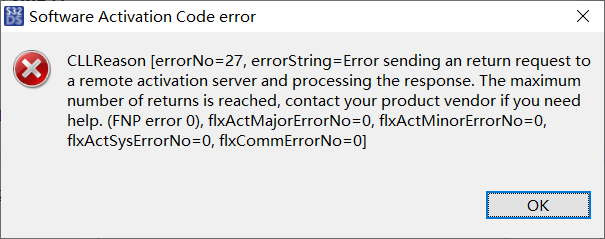

thomaswhitburn
I see an entitlement and license expiration of 9/22/21 in my License List page.  When I try to use the old activation code in the IDE I get this error:
10,072 Views
mikedoidge
Hi @thomaswhitburn,
I understand now. You are still using the v2.0, even though you now also have the v2.2.
I will extend your entitlement for the v2.0, but I encourage you to upgrade to the v2.2. However, if you are working with the S32K1xx family devices, I would recommend that you migrate to the S32 Design Studio for S32 Platform v3.4. This is our latest version and is upon which the recent and future updates have been and will be made going forward.

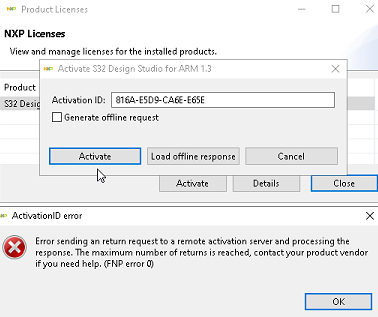

609510318
Thanks.I try to  return  license, but the error happens as follows.Could you help me to solve it?
31,723 Views
mikedoidge
I have returned your license, when you re-activate, the new expiration date will be loaded.
