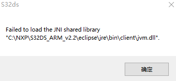

hello @mikedoidge
This error occur at  the first time launching the S32DS for Arm 2.2 following installation
installation log file is attached

Hello @NicholasJun2021 ,
This issue appears to be the result of 32-bit vs 64-bit Java. S32 Design Studio for Arm uses 32-bit Java, which is included in the install. However, you have 64-bit Java installed on your PC as well. For some reason, the S32 Design Studio is being forced to use the 64-bit Java, which it is not designed for and this causes the error you see.
If possible, you could try to remove the 64-bit Java temporarily and then try to execute S32 Design Studio. If it launches cleanly, then we know this is the cause.

Hello @NicholasJun2021,
Did this error occur at your first time launching the S32DS for Arm 2.2 following installation?
If so, please provide the installation log file:
C:\NXP\S32DS_ARM_v2.2\_S32 Design Studio for ARM Version 2.2_installation\Logs\S32_Design_Studio_for_ARM_Version_2.2_Install.log
Did the S32DS for Arm 2.2 work well previously and this error appeared just now?
If so, please provide the .log file from your workspace:
"C:\Users\<userid>\workspaceS32DS.ARM.2.2\.metadata\.log"
If the log file is not recent, please provide some details on what is shown prior to the error message.
