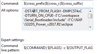

I noticed in one of my projects, the SREC has the boot record embedded in the record, the second project does not.
   S30900FA0000005A0002A0   /* Boot Header */
   S30900FA001001000000EB   /* Program Code Start Address */
I believe all I have to do is, in the project properties, under C/C++ Build Settings, in the Standard S32DS C Compiler Section, I double click the START_FROM_FLASH symbol. So, I did that.
When I recompile, I still do not see the Boot header. "005A0002"

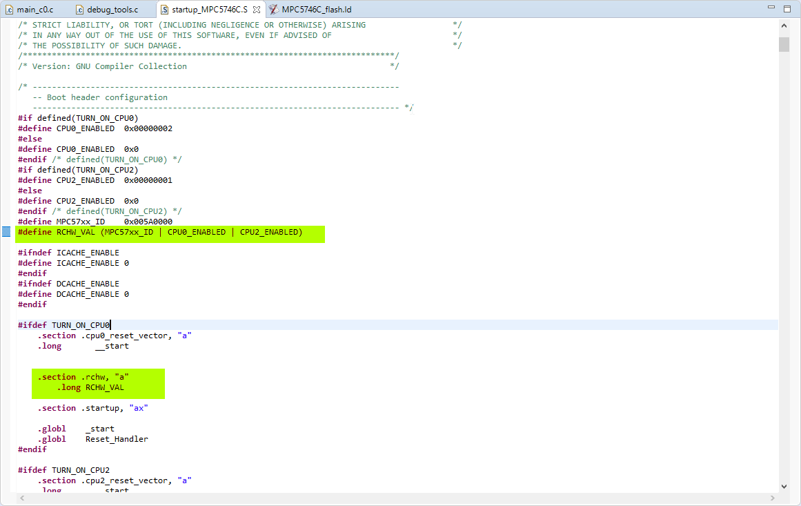

jiri_kral
the BootHeader must be present in the code - ideally in startup.S. Mine startup (default one) is also assembly file, but you can see that there is store RCHW_VAL to .rchw section on address (taken from linker file) 0xFA0000. So, it is user responsibility add bootheader to one of the 11 addresses. You can find more details in chapter 55.1.4 (page 2250 in reference manual https://www.nxp.com/docs/en/reference-manual/MPC5746CRM.pdf  )

jiri_kral
please check startup_MPC5746.S file - that's where RCHW_VAL is normally defined for S32DS Projects and added into .rchw section:
