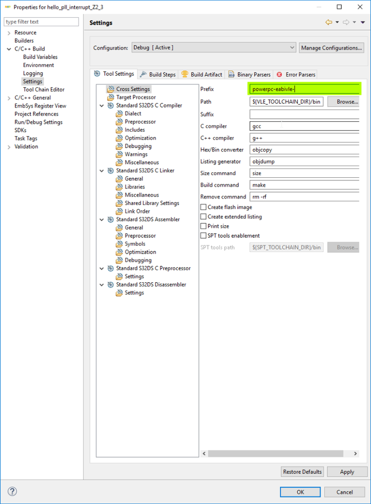

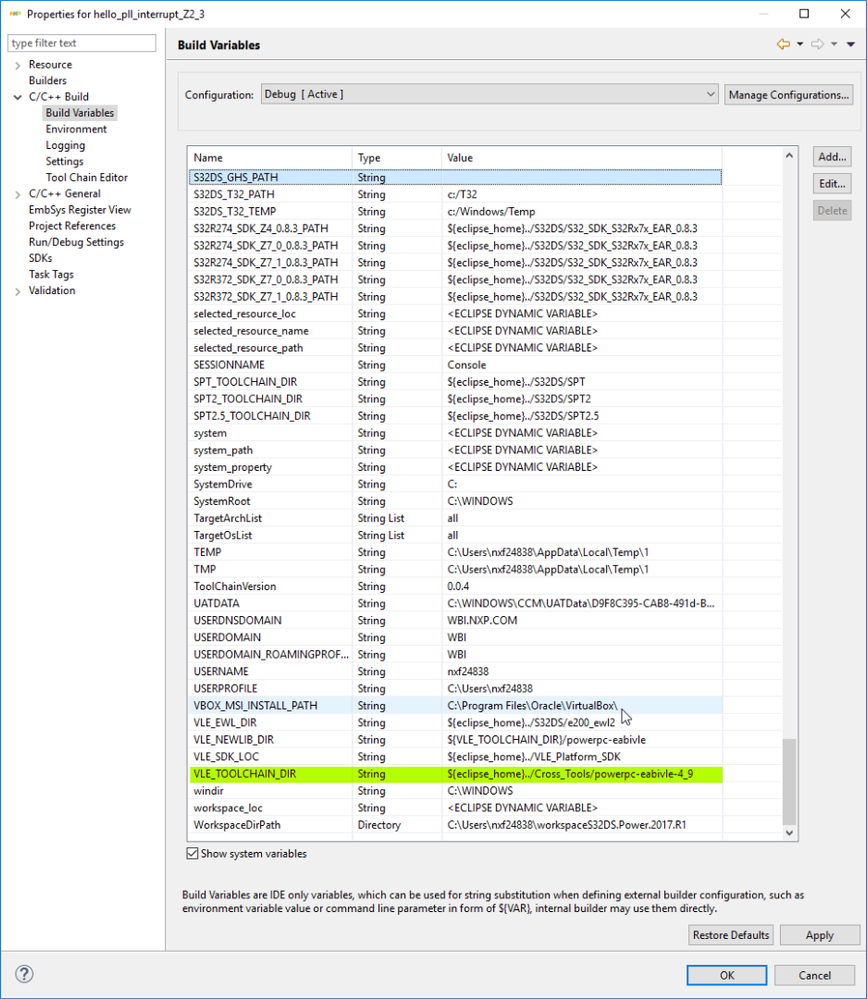

jiri_kral
please check if you have set the prefix for gcc:
and VLE_TOOLCHAIN_DIR/bin points points to folder with cross tools binaries. Also check if the binaries are physically present on the hard drive.
