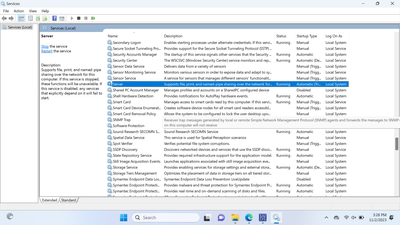

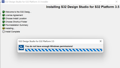

While installing S32 Design studio - Thrown with "You don't have enough Windows permission" error. Can anyone help to resolve this issue? Windows "Server" service is enabled. Logs as follows:

Status: ERROR
Additional Notes: ERROR - Error writing LaunchAnywhere components (Access Denied)

Can someone please help to resolve this issue?

Hi, @Sandy90 ,
Please make sure that you have administrator right privileges while installing the S32DS.
If you are having issue with administrator privileges please also check with your company's IT team, if firewall blocking or any other issue.
Please follow this guide for activation:
 https://community.nxp.com/t5/S32-Design-Studio-Knowledge-Base/HOWTO-Activate-S32-Design-Studio/ta-p/...
Please follow the S32DS guide while installing S32DS: https://www.nxp.com/webapp/Download?colCode=S32DSIG
If you are still having issue. Please update us.
Thank you. Best regards.

Hi, @Sandy90 ,
Last week there was some server issue, please can you retry installation.
Thank you. Best regards,
