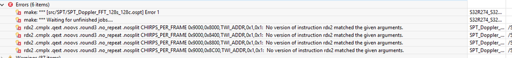

I have updated to S32 Design Studio 2017.R1 (From 1.2) and it seems that most of the SPT assembler is now broken/nonfunctional ?
Has there been a change in the syntax  ?
All my SPT asm code that was running fine on the older version is now having build errors.
Also the SPT graph is totally non-operational. See errors at bottom of message.

Error reported:
Description         Resource             Path       Location              Type
pdma .signext .notag .16real .sysram2opram .async 0x080 0xDEADBEEF,0x8000,0,1,0,1:
No version of instruction pdma matched the given arguments.
I’m getting these errors for all these instructions:

Update:    SPT graph failure was caused by Project_Z4.aird file had a old project path that does not exist.
                Manually changing the path to the current workspace fixed the problem. Why the import / update process
                didn't pick this up i don't know.
SPT assembler seems to be pointed to the wrong assembler, it seem to be the SPT 1.x assembler.
I can command line assemble the code using the 2.0 and 2.5 assembler. the 1.x creates the errors.
The path to the assembler should be
           SPT Tool Path  ${SPT2_TOOLCHAIN_DIR}/bin
in the settings, but it seems to be ignored.
I can find any place where SPT2_TOOLCHAIN_DIR is defined.
Hard coded it to  C:\NXP\S32DS_Power_v2017.R1\S32DS\SPT2.5\bin, but still the same problem.
It seems some setting/configuration in the project is pointing it to the SPT 1.x assembler.
This what is in the path. It's not tracking the project settings.
   C:\NXP\S32DS_Power_v2   017.R1\eclipse\..\S32DS\SPT\bin;
 Problem found: You must reboot your windows box, it seems that S32DS updates the PATH and it is out of date utill you reboot. After the reboot the SPT assembler issue went away.

I have work with S32DS power architecture V1.1. When I was upgrade my S32DS to version 1.2 I have a lot of SPT errors such as:
pastedImage_1.png all of them related to No version is matched
My SPT is an assembly code. It seems that the SPT versions does not matched. The above path and comments are not clear for me. Where should I change the SPT path or version? Is there any setting in the project to change it?

I don’t think it’s a path issue, I think it is a slight change in the format of the RDX2 instruction.
Try formatting like this, this is working for me.
rdx2 .cmplx .no_repeat .qext .noovs .round3 .nosft .nosplit CHIRPS_PER_FRAME 0x9000, 0x8000, TWI_ADDR_128_UNIF, 1, 1
