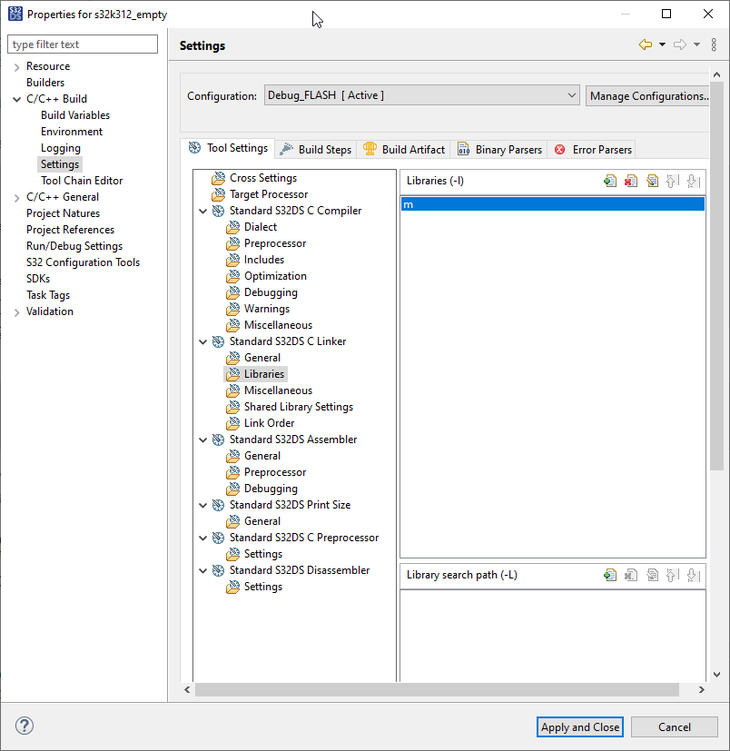

when I bulid a project using S32 DS,there are some problems like:
Ld errors:undefined reference to 'floors'
Actually,floors is a function which is defined in <math.h>
FAE from agent gives me a solution and it works:
 change the configuration in libraries support(properties->settings->Target Processor):
newlib no I/O (-specs=nosys.specs)    -> ewl_c no I/O(-specs=ewl_c9x_noio.specs)
sysroot is also modified automatically.

jiri_kral
you switched STD C library from NewLIB to EWL (old STD C library maintained by NXP) and there is included math library, normally is math library standalone lib archive. .
 I recommend use NewLIB and simply add math library into your project like on screensthot. Right click on project name -> Properties -> C/C++ Build -> Settings -> Libraries:
