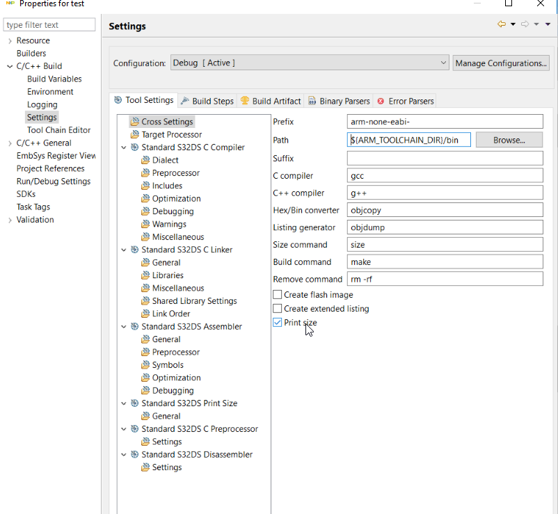

jiri_kral
enable print size for your project by right click on project name -> properties -> C/C++ build -> settings
Perfect article related to GNU size utility is here: text, data and bss: Code and Data Size Explained | MCU on Eclipse
Hope it helps.
