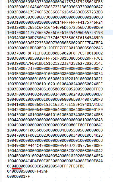

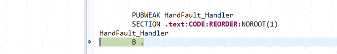

         I compared the running status of the same piece of code in the S32DS environment with and without IAR plug-in. The running status of this piece of code in the S32DS environment without IAR plug-in was OK, but in the S32DS environment with IAR plug-in, this piece of code could not run normally, and directly entered the hardware interrupt.So I did another test where I blocked some of the code (as long as it didn't interfere with the program) and it worked in the S32DS environment with the IAR plug-in.I looked at the generated. Hex file, which showed my code was 0x04D0, so there should be no problem with too much code and insufficient compilation space.It is the first time for me to use the IAR Eclipse Plug-in and I have no experience. Could you please help to solve this problem?

I'm very sorry that I can't provide the compressed package of the whole project. The reason is that our computer has encryption software and has no permission to send out data.I have compared project/example generated for GCC compiler and IAR compiler. The project/example generated for GCC compiler can run normally, but the project/example generated for IAR compiler failed to run.That causes HardFault Exception.The two contrast examples are running the same code. The difference is GCC compiler vs. IAR compiler.So I ran another set of tests in which I ran a failed project (with IAR Compiler) and deleted some of the code (provided that it didn't affect the code), as shown in the HEX file above, and the firmware size was within 0x04D0, the project would run successfully.
