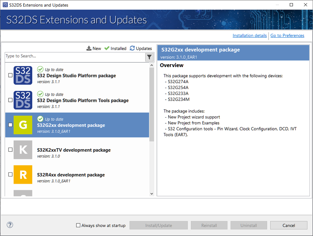

I have installed the internal device package for S32G, see below picture:

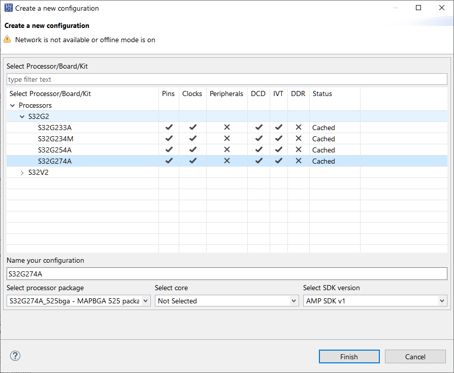

And after I launched the ConfigTools with below selection:
The DCD tool seems can not be opened:
I want to confirm if the DCD tool available in this version?

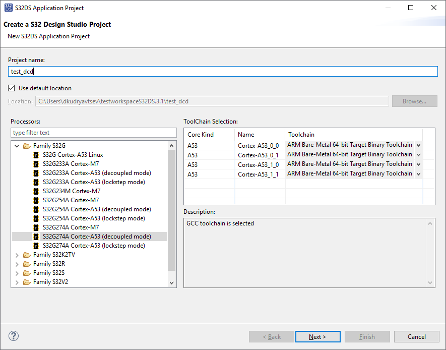

1. File->New->S32DS Application Project, Select S32G274A Cortex-A53

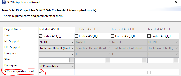

2. Select "S32 Configuration Tool"

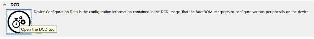

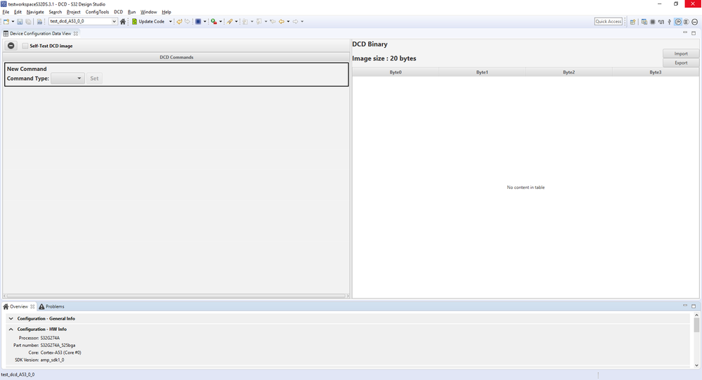

3. ConfigTools->DCD
4. You are welcome :smileyhappy:
